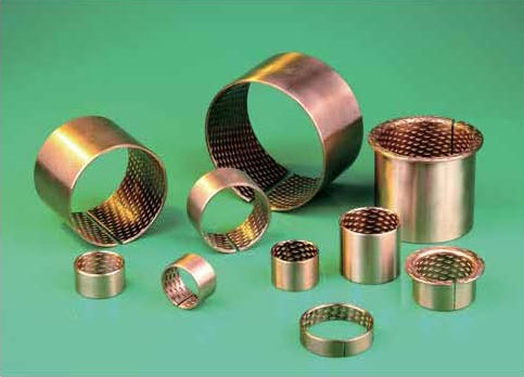

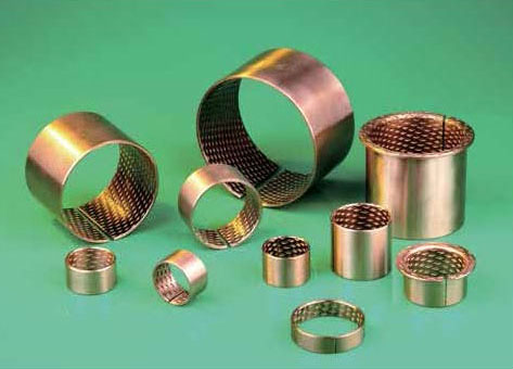

Epen E90 bronze wrapped bushings Brief Description
EPEN E90 bronze wrapped bushings are made of entirely bronze CuSn8. Because of material properties, the working surface rolled with diamond Indentations (standard Indentations) or stamped oil grooves according to detailed application. And it also has good Performance of anti-corrosion caused by chemical and environments. During the operation, the grease & oil will be released from the Indentations, which allow for long-term lubrication. Compare with Machined bronze bearings; E90 can offer some advantages including thin wall, lower weight, cheaper cost, high load etc. It is suitable for high load, lower speed application like construction, Transport, and agriculture machinery.

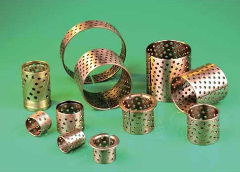

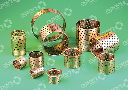

E92 is deriving from E90; the difference between E90 & E92 is Indentations on working surface, which substituted by Through-holes. Theses holes will allow greater capacity to collect lubricant, which build up a lubrication film at the start of movement and reduce the frication. It is suitable for high load, lower speed application like construction, Transport, and agriculture machinery.
