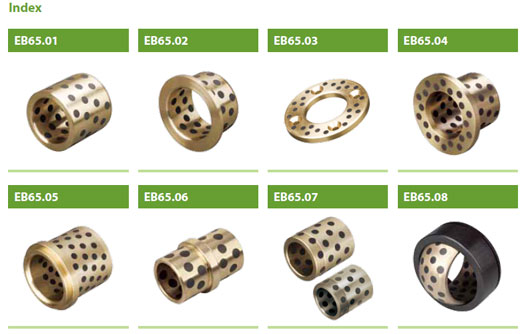

EB65 Product Profile
Solid lubricated bearings are sliding blocks are self-lubricated bearings are obtained by means of drilling orderly arranged holes in proper size on the surface of metallic matrix of the bearings before filling the solid lubricant with self-lubrication capability (the area of the solid lubricant applied is usually 20% to 30% of the abrasion area). The bearings integrate the advantages of both the metallic matrix and the specially formulated Iubricants and break through the limitation of the ordinary bearings, which depends on the oil for lubrication.

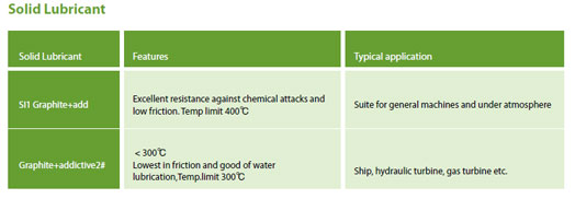

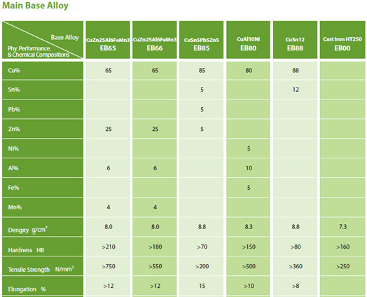

The solid lubricant bearings are especially suitable for oil-free, high-temperature, high-load, low-speed,anti-fouling, anti-corrosion, anti-radioactivity circumstances as well as the special circumstances in water or vacuum settings where it is impossible to add oil for lubrication. This product is widely applied to the steel rolling equipment, filling equipment, water turbines, steam turbines, instruments and meters as well as mine machinery, vessel machinery, textile machinery, ship building industry, cosmonautics and navigation, etc. They can be used for general engineering machinery too. The base materials of solid lubricant bearings shall be determined according to the working conditions of the bearings.The commonly used materials high-strength copper, tin bronze and cast iron, etc. The filled solid lubricant is mainly graphite and addictive. Various additives are for various working conditions. Therefore, according to the working conditions of the bearings, a mix of metallic matrix and filled solid lubricant can enable the products to meet the specific requirements in various conditions with various temperatures, loads, movements and ambient substances and meanwhile, ensure stabilized and reliable functioning.

Since the linear expansibility of solid lubricant is greater than metallic matrix’s, when the movement of solid lubricant bearings(SLB)start, the lubricant is transferred onto the parts in abrasion thus realizing the self-lubrication. Therefore, the SLB can be used in circumstances where oiling and greasing is difficult or impossible and they perform excellent lubrication even under low-speed and high load circumstances.

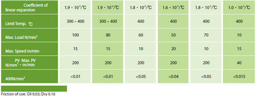

4. Excellent performance under high-load, low-speed circumstances
The SLBs are made of rotational cast high-strength copper as the matrix, which functions as load bearers.Besides, SLBs use specially formulated graphite as lubricant, ensuing excellent self-lubrication. Combining the advantages of both the matrix and lubricant, SLBs are capable of expert their wonderful performance in circumstances with high load and low speed.

The lubricant for SLB is formulated out of the abrasion-resistant materials such as graphite and PTEE and has stabilized molecular structure. The metallic matrix can be selected according to the various chemical resistance and corrosion resistance accordingly. Therefore, the SLB enjoys high chemical resistance and corrosion resistance.
