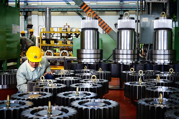

SKF heavy lifting 1
Gear setting for key machining at the Hyosung plant.
