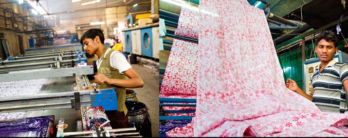

In typical textile printing machines, hydraulic cylinders are used to lift and lower the printing platforms that create a textile pattern. High energy consumption is not the only environmental downside to these systems: 400 litres of hydraulic oil per year per machine are used to run the two hydraulic actuators installed in each Indian Textile Engineers machine.

Hydraulic systems require a constant power supply, even when the actuators are not performing their task, whereas electromechanical solutions only consume energy during movement. Electromechanical power transmissions do not require oil, eliminating its consumption and leakage on machines and mill floors. It also improves the working environment for machine operators through reduced noise and vibration levels.
Together, SKF and Indian Textile Engineers explored a number of different actuator models. After extensive trials, they settled on the SKF CASM electromechanical cylinder, which can handle the heavy loads and high speeds required by a textile printing machine whilst also increasing production. Two electromechanical actuators were installed in a machine as a trial, and the observed reduction in energy use was significant, estimated to be 7 MWh per year (equalling 5.3 tonnes of CO2 emissions per year, according to world power grid mix CO2 factor of 0.749 kg CO2e/kWh).
The next step was to test the solution at some customers’ operations. The energy savings amounted to approximately 120 euros per month per machine, and with about 5,000 machines running in the country, Indian Textile Engineers sees huge potential for energy and money savings. Moreover, one Ahmedabad mill increased its productivity from 600 to 850 metres per hour by changing to SKF CASM electromechanical cylinders.
The successful installation of 17 actuators for Indian Textile Engineers has led to the ordering of another 300 SKF CASM electromechanical cylinders in 2012, to be installed in brand new printing machines as well as in machines already operating at various textile mills.
